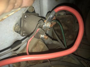

I got a new battery for my new old to me new free bronco. 85xlt automatic 4x4. I tried to see if it would turn over. Wipers work door lock on passenger side works.

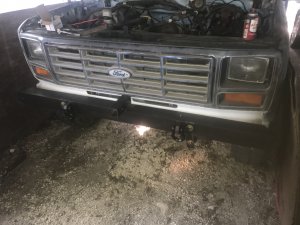

I tried starter and nothing cranks. Do I need to change selonid? I’m gonna jump it in the morning with a screw driver? Second photo is front bumper I built out of 4”angle for a winch so I can use it back or front it’s getting bolted on mañana morning
Anyone have suggestions on motor would appreciate help 3BCEBF1E-D19D-4D74-B2F5-0161321E6322.jpeg
Anyone have suggestions on motor would appreciate help View attachment 21639

hey there! i don't come here often but here it goes.
if you have a multi meter it really helps to understand where the electricity is going, or not for that matter. let us know if you have/know how to use the multi meter... it makes it easier to help you as we can ask the right stuff.
do ya hear a loud click from the fender mounted solenoid? if so, it's likely the starter, solenoid, or large wiring between engine block, starter, battery, etc.
if not, it could be a problem with the neutral safety switch/park-neutral switch or the ignition switch or associated wiring that powers the solenoid's input terminals via the said switches. or in some cases the solenoid itself..
it's somewhat common to have damaged/overheated electrical connections with these rigs as they have a direct drive starter as opposed to one with a starter motor with gear reduction like most modern rigs.

I crossed the terminals with a screw driver and engine turned over.
the solenoid looks original so I bought a new one. Will put on mañana. If not I’ll put the meter on it. thanks guys
