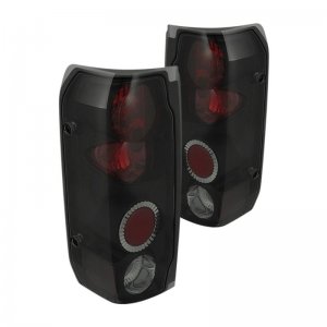

LED bulb in the old tail light socket will not make a big difference. If you want to upgrade the look you can get some new replacement taillights with aftermarket design.
they are relatively inexpensive. Check them here: http://www.carid.com/1993-ford-bronco-taillights/
