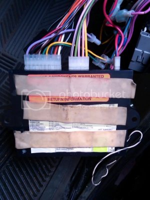

Hi Miesk5
Trying to locate this on my 95 bronco not in location shown in pic
black box behind glove box
any other known locations?

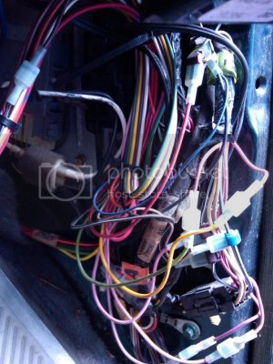

still cant find connector

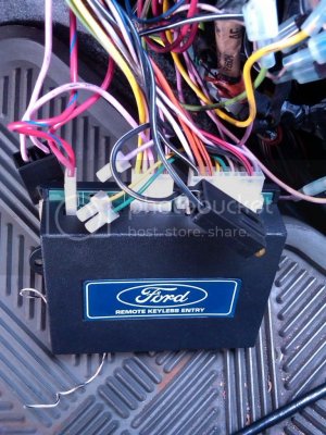

here is pic of keyless entry module for my 95 bronco found behind glove box.
Wires lead to under kick panel (spaghetti!! :( /emoticons/[email protected] 2x" width="20" height="20" /> )

oh also some ******** double sticky taped the wiring diagram on the back so I cant read which wires are what :((
