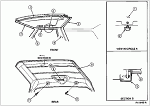

Are the three driver side visor screws tight?
And same for the drive side Drive Pin?
ItemPart NumberDescription
151944Roof Trim Panel
2383927-SDrive Pin (1 Req'd Each Side)
342410Moulding
431012Quarter Trim Panel
529010Body Side Garnish Moulding
63598Front Body Pillar Inside Moulding
703606Windshield Garnish Moulding
8519C14Roof Trim Panel, Rear
913K706Rear Cargo Lamp
1013K707Rear Courtesy Lamp Lens
1102354Cowl Side Trim Panel Retainer (2 Req'd)
