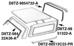

going to replace the hard top weatherstripping, I've seen a vid  showing the use of contact cement  prior to the rubber,
when i ordered the kit i asked and they sad no, just one piece has a adhesive strip.
would appreciate  the correct info.
thanks guys

No adhesive needed.except for that one piece as described below;
Weather Seal Location Diagram; "...There's 1 weatherstrip across the back of the cab that slips onto a lip of steel, and a reinforced rubber trim that covers another lip, but it doesn't seal anything. Then there's a foam rubber gasket glued under each side of the shell, terminating in a large foam block at the tailgate. So that's a total of 4 pieces, but only 3 are seals. Only the weatherstrip on the cab is marked in the 1st diagram, but all are shown in cross-section. ..." by Steve at

REMOVABLE ROOF PANEL SEALS Diagrams, 78-96 w/Ford part numbers;
D8TZ-9851322-A Removable Roof Front Seal On fiberglass roof;
D8TZ-98513C22-PR Removable Roof Side Panel Seals on 78-79;
D8TZ-9854732-A Front Roof Rear Seal on metal roof on 78-79;
E1TZ-98422A20-A Back Window Glass Lower Side Run, RH or LH on 78-96
Roof Rail Seal ATTACHES TO THE REAR OF THE METAL CAB 78-79
Part #: D8TZ-9854732-A
$40.95
Source: by bwautoparts.com via web.archive.org
http://web.archive.org/web/200603171...at2003.062.htm
You must be registered for see images attach
Camper Top Location Diagram #1; "...There's 1 weatherstrip across the back of the cab that slips onto a lip of steel, and a reinforced rubber trim that covers another lip, but it doesn't seal anything. Then there's a foam rubber gasket glued under each side of the shell, terminating in a large foam block at the tailgate. So that's a total of 4 pieces, but only 3 are seals. Only the weatherstrip on the cab is marked in the 1st diagram, but all are shown in cross-section..."

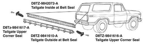

Weather Seal, Outer, Rear Glass Run Seal Removal (broncograveyard pn 34543 for 80-96); "...Use a screwdriver to gently pry the OUTER weatherbelt up just enough to pop the cllps loose. I've pulled the far end out to show the clips, but it should be left straight until ALL the clips are loose, then lifted out without bending. The inner seal is removed the same way, but use a rag between the screwdriver and the paint..."
Source: Steve83 (Steve, That dirty old truck) at SuperMotors.net
Weather Seal, Camper Top Weather Seal, Glass Run Info & Ford pn; "...Some aftermarket versions are simply a continuous strip - they lack the formed corner pieces at each end..."
Source: by Steve83 (Steve, That dirty old truck) at SuperMotors.net

Weather Seal Parts Break-Out Diagram; "...The outside weatherbelt that wipes the glass is D8TZ-9841610-A and cost $24 in 1996. The inner (9841676 above) is F6TZ-9842072-AA and was $27. Use silicone spray **** on the weatherbelts & glass runs. The best grease for the slides & tracks is this: Teflon grease..."
