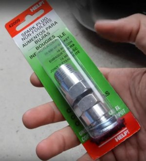

You still need the first oxygen sensor to keep the engine running correctly.
You can install the second oxygen sensor, even though there is no Cat. If you use a spark plug anti fouler the engine light will not come on. You can find them in most auto parts stores in the help section.
Been a while but I am thinking you have to drill it out some to clear the sensor.
If you don't install the 2nd oxygen sensor then you will need ECM programming to keep the light off. I have no idea who does that stuff anymore.

Tiha, thanks you for the info. I will try and find the spark plug anti-fouler at a store just in case I decide to go that route.
