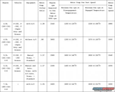

B5 - Cannot run test there is no Fan Clutch Spec for 5.8l 351w (please advise if fan clutch spec is available somewhere else for 5.8l) I think I installed a severe duty fan clutch when I changed it a couple years back (is this OK?) I was doing a bit of towing at the time and thought this would be better, not much towing these days though

I checked other year Bronco and F 150 fan clutch specs and they too don't list the 5.8 either.  Local dealer service manager may be able to help.  However our local Ford dealers managers just want to rack up bogus "needed repairs".
Did find one Bronco Technical Service Bulletin (TSB).  A TSB is used to correct errors in manufacturing, changes to components, etc.TSBs frequently (but not always) address a recurring problem and include illustrated instructions for repair, a list of the parts needed, the warranty status and the labor charge.
Here it is, but no 5.9 Specs
TSB 92-15-14 Fan Clutch DiagnosisPublication Date: JULY 15, 1992LIGHT TRUCK: 1987-92 BRONCO, ECONOLINE, F-150-350 SERIES1988-92 F SUPER DUTYISSUE: A comprehensive diagnostic procedure has been developed for determining if the engine cooling fan clutch is functioning properly. A fan clutch that is not functioning properly may cause engine cooling concerns and/or vibration.ACTION: Use the following diagnostic procedure to determine if the fan clutch is functioning properly. A fan clutch that is not functioning properly should be replaced.CAUTION: DO NOT ATTEMPT TO MODIFY THE BI-METALLIC COIL ON THE FACE OF THE FAN CLUTCH.DIAGNOSTIC PROCEDURENOTE: PROCEED ONLY AFTER COMPLETING THE ENGINE COOLING DIAGNOSIS PROCEDURE IN SECTION 03-03 AND THE ACCESSORY DRIVE BELT TENSION PROCEDURE IN SECTION 03-05 OF THE APPROPRIATE SERVICE MANUAL.1. Turn off the air conditioner, heater-A/C fan and radio.2. Check for viscous drag...a. Before starting the engine, rotate the fan and clutch assembly by hand. It should have some viscous drag, but it should turn smoothly during the full 360� of rotation.b. Replace the fan clutch if it does not turn smoothly or does not turn at all. Refer to the Dealer Master Parts Catalog for correct parts usage. Refer to the appropriate Service Manual, Section 03-05, for service details.c. Replace the fan if there are only cracks.d. If this is not the concern, go to Step 3.3. Check for lack of viscous drag...a. If the fan clutch spins with no viscous drag when it is cold, and it has not been run for an hour or more, it should be replaced. Refer to the Dealer Master Parts Catalog for correct parts usage. Refer to the appropriate Service Manual, Section 03-05, for service details.b. If this is not the concern, go to Step 4.4. Check for excessive fan clutch bearing clearance (cold fan clutch)...a. Hold the tip of the fan blade between the thumb and forefinger.b. Lightly pull toward the radiator, then push toward the engine. c. Repeat the motion several times.* The total rocking movement at the end of the fan blade should be 2/10" (5.1mm) or less when no more than eight ounces of force is applied.* A force greater than eight ounces may deflect the fan blade with erroneous results.d. Replace the fan clutch if more than 2/10" (5.1mm) of movement is observed. Refer to the Dealer Master Parts Catalog for correct parts usage. Refer to the appropriate Service Manual, Section 03-05, for service details.e. If this is not the concern, go to Step 5.5. Install a temporary engine tachometer if the vehicle is not equipped with a tachometer.NOTE: DURING THE FOLLOWING TESTS, BE SURE TO MONITOR THE ENGINE COOLANT TEMPERATURE BY THE TEMPERATURE GAUGE IN THE INSTRUMENT CLUSTER. SHUT OFF THE ENGINE IF THE TEMPERATURE RISES ABOVE THE MAXIMUM RECOMMENDED LIMIT FOR THE ENGINE OR IF COOLANT IS DISCHARGED OUTSIDE THE SYSTEM. THE TESTS CAN BE RESUMED USING THE FOLLOWING PROCEDURES AFTER THE COOLANT TEMPERATURE DROPS TO A NORMAL OPERATING LEVEL.NOTE: IF THE HOOD IS LEFT OPEN, THE FAN NOISE MAY BE EASIER TO HEAR.WARNING: DO NOT STAND IN LINE WITH THE FAN.6. Start the engine.7. Check for fan disengagement and be aware of the following operational characteristics.* The fan clutch may be engaged when the engine is first started. This will be apparent from the noise level of the fan which has a distinctive roar.* The fan clutch engagement is due to the viscous silicone fluid draining back and filling the gap between input and output components.* Running the engine at a constant speed of about 2000 rpm should pump the fluid back to its reservoir, disengaging the fan clutch after no more than five minutes.* As the fan speed declines, the noise will drop off to a level inaudible to most observers.a. Continuing the test, If the fan clutch does not reengage after five more minutes at 2000 rpm, the fan clutch should be replaced. Refer to the Dealer Master Parts Catalog for correct parts usage. Refer to the appropriate Service Manual, Section 03-05, for service details.b. Repeat the test procedure after fan clutch replacement to confirm the fix and to assure customer satisfaction.c. If this is not the concern, go to Step 8.8. Stop the engine.Cut and install a piece of cardboard large enough to cover the front of the radiator with a six inch diameter hole in line with the fan clutch.If it is not possible to install the cardboard directly against the radiator, attach it to the A/C condenser.9. Start the engine.a. With the gas engine at 2700 to 3000 rpm or diesel engine at 2100 to 2300 rpm, the vehicle temperature gauge will rise steadily as the engine warms and then appear to level off for a short time when the thermostat opens.b. Make note of the temperature gauge position when the thermostat opens. The engine coolant temperature will continue to rise until the fan clutch engages.10. Check for fan engagement...a. Continue to observe the coolant temperature gauge. As the fan clutch engages, the fan noise will continue to increase and then level off at full engagement. The fan clutch may cycle off-and-on a few times during the initial engagement.b. If the fan clutch does not engage before the maximum indicated safe operating engine coolant temperature is reached, it should be replaced. Refer to the Dealer Master Parts Catalog for correct parts usage. Refer to the appropriate Service Manual, Section 03-05, for service details.c. Repeat the test procedure after fan clutch replacement to verify the fix and to assure customer satisfaction. The rate of rise of the coolant temperature will slow down after clutch engagement, but it will continue to rise as long as the radiator remains covered.d. If this is not the concern, go to Step 11.11. Check for fan disengagement...a. After completion of the above tests, shut off the engine.b. Remove the cardboard cover from the front of the radiator.c. Restart and return the gas engine to 2700 to 3000 rpm or diesel engine at 2100 to 2300 rpm, continuing to watch the coolant temperature which will begin to decrease. The fan rpm will drop to a reduced noise level where it was before the cycle began which indicates that the fan clutch has disengaged.d. If the fan clutch remains engaged and the coolant temperature has dropped below the thermostat opening temperature (as noted in Step 9) for at least five minutes, the fan clutch should be replaced. Refer to the Dealer Master Parts Catalog for correct parts usage. Refer to the appropriate Service Manual, Section 03-05, for service details.e. Repeat the test procedure after fan clutch replacement to confirm the fix and to assure customer satisfaction.OTHER APPLICABLE ARTICLES: NONEWARRANTY STATUS:Eligible Under Bumper To Bumper Warranty Coverage For 1992 Models, Basic Warranty Coverage For All Other ModelsOPERATION DESCRIPTION TIME921514A Diagnosis Only - F-Series And Bronco 0.6 Hr.
fanclutchtest.jpg | Hits: 7484 | Posted on: 1/25/06 | View Low-Res

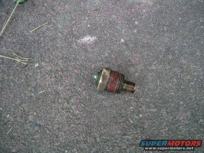

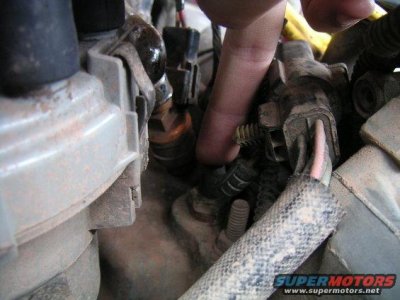

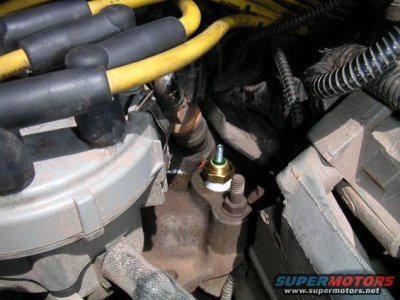

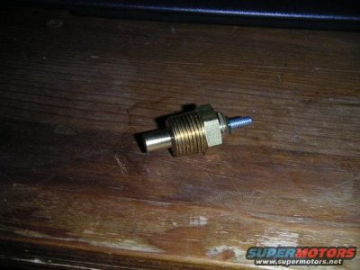

Bad news is when I went to change out my Temperature gauge sender, I buggered up the brass 6-point top of it and now can't get it out , stuck good with nothing left to get a socket on.
Any suggestions?
Thanks in advance
Yo tjg,
This often happens.  Use penetrating oil or make your own w/acetone (or nail polish remover) and ps fluid or auto trans fluid, 50/50 mix. Let it soak in for 20 minutes.
Tap around the brass body.
Most use a slightly smaller socket to tap into place. Or a tool similar to a Bolt Extractor https://www.amazon.com/Tools-Power-Grip-Extractor-7-Piece-394100/dp/B000EF1EHY/ref=asc_df_B000EF1EHY/?tag=hyprod-20&linkCode=df0&hvadid=309763890402&hvpos=1o1&hvnetw=g&hvrand=13312005223394683489&hvpone=&hvptwo=&hvqmt=&hvdev=t&hvdvcmdl=&hvlocint=&hvlocphy=9003904&hvtargid=pla-423287065638&psc=1
Our former local MOM and POP parts store would loan it out to regular customers. Now, the chain store owners quit helping. OTC automotive tools seem to dwell on recent years and current. Ford model years.
Blazenxlt did this;PICT0011.jpgpointing right on the old one, kinda a bitch to get to.PICT0007.jpgnew unitPICT0002.jpg➡️old one out, took the trusty dremel to it so I could fit a rachet on it brownbag.gifPICT0001.jpgnew one in."
In past, some mechanics would use a Dremel remove some brass to fit a smaller socket on.
"Use a sensor safe liquid thread sealant to coat the threads before installation.
Using a tape type of sealant may electrically insulate the sensor not allowing the gauge to register.
Install a new sensor.Tighten the 6-14 ft. lbs. (8-19 Nm) using a box-end wrench or sending unit pressure switch socket.

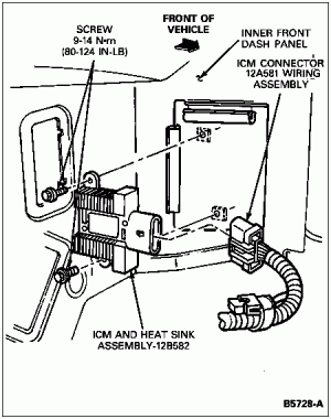

A little off the topic but ...Do you have the correct part number for the Ignition Control Module for my 1995 Bronco 5.8l with CA emissions?
Please correct me if I am wrong, but from what I understand there is some confusion surrounding this part due to an error in Ford's part listing to aftermarket vendors which apparently was never corrected.
When I search O'reilly's, Summit Racing, Amazon, etc. they all direct me to p/n DY1075 which is a grey icm, my Bronco most definitely has a black icm which I think the replacement is p/n DY1077 but shows as incorrect part or not listed as available for my vehicle in the stores databases, Amazon sellers will not even ship a DY1077 to me in California due to Ca Air Board restrictions.
Thanks for the help
TJG
Yo T,
ignition control module DY 1077 from Rock Auto is Genuine Ford Motorcraft®⚠️

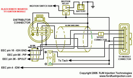

Remote Mount Black CCD "Computer Controlled Dwell" ICMFord Bronco -remote_TFI_harness2.gif[/IMG]Motorcraft - DY1077 (supercedes DY679, DY667, DY645)Ford - 5U2Z-12A297-D (supercedes F1PZ-12A297-A)Wells - F139Niehoff - FF413BWD - CBE40Standard - LX-241NapaEchlin - TP29Delphi - DS10056Transpo - FM544I am fairly confident in my research, except for the non-Bronco Distributor Mount Black CCD ICM. I do not believe that the Bronco ever came with this so another Ford ICM is subsituted. What I looked for was a 6+3 Pin "Black" Ford TFI Ignition Control Module and crossed referenced it to other brands." by Seattle FSB @ https://www.fullsizebronco.com/forum/23-technical-write-ups/183668-ford-tfi-ignition-control-modules.html

Section 03-07A: Ignition, Distributor
1996 F-Series and Bronco with Gasoline Engines Workshop Manual
REMOVAL AND INSTALLATION
Removal
  1. Remove two screws retaining ignition control module (ICM) (12A297) heat sink assembly to left fender apron.
  1. Disconnect harness connector from ignition control module.
  1. Remove two screws retaining ignition control module to heat sink and remove ignition control module.
Installation
  1. Coat ignition control module baseplate with silicone compound, approximately 0.0179mm (1/32-inch) thick. Use Silicone Dielectric Compound (WA-10) D7AZ-19A331-A or equivalent meeting Ford specification ESE-M1C171-A.
  1. Position ignition control module onto heat sink and tighten two retaining screws to 1.2-1.8 Nm (11-16 lb-in).
  1. Install ignition control module heat sink assembly on left fender apron using two retaining screws, and tighten to 9-14 Nm (80-124 lb-in).
  1. Connect wiring to ignition control module.
