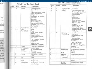

Try a Self Test for Diagnostic Trouble Codes by my pal, BroncoJoe19 @ Code Reader.....
The engine temperature must be greater than 50° F for the Key On Engine Off (KOEO) Self-Test and greater than 180° F for the Key On Engine Running (KOER) Self-Test. Run it around to heat the engine up and shift thru all gears including Reverse. Make sure A/C is off and transmission is in Park (automatic); or in Neutral for a Manual and; release clutch. Then turn off engine, all accessories/lights (close driver's door) , etc.
Do KOEO test First. Post Code(s) here according to KOEO and KOER.
A helper can assist you by counting the codes. Some use their smart phones to record them.
BEWARE OF FAN, BELTS, PULLEYS, HOT HOSES, IGNITION HIGH TENSION WIRES, AND ENGINE COMPONENTS⚠
Or ask local mom and dad parts stores if they will test it for you.
Or purchase a coder reader such as Equus 3145 Innova OBD I Code Reader for Ford EEC IV Engines at Walmart & most parts stores.
With no applicable Codes ;
Here are the:
1990 Bronco Pre-Delivery Shop & Electrical & Vacuum Troubleshooting Manuals (EVTM), Partial by member Kingfish999 in Google Drive @ 1990 Ford Truck service manuals - Google Drive
1990 Ford Truck Emissions Manual.pdf by Ford via member 90.CaliBronco in Google Drive @ 1990 Ford Truck Emissions Manual.pdf
Suggest you download both for faster scrolling and to use the table of contents index.
1990 Ford Bronco Brochure by Ford via Dezo's Garage @ https://www.xr793.com/wp-content/uploads/2020/07/1990-Ford-Bronco.pdf
