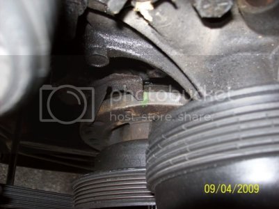

Make sure your timing marks are clean and can be read. These are located on the harmonic balancer. Clean them up with a wire brush or some sandpaper. Mark 10* BTDC with a white/yellow crayon. There will be two 10's showing, you want the red 10 below. The marks will look like:
ATC10||||0||||10||||20||||30BTC (Each "|" represents 2 degrees)

Locate your 10* BTC and this should be relatively close to your timing pointer. It might be before or slightly after. If it's before (spinning in clockwise direction), turn it so the 10*BTC lines up with the pointer like so. If it went past the timing pointer, then you can either turn it counter clockwise to meet the mark, or spin the crank so that the 10*BTC mark passes the timing pointer once (going clockwise) and stopping on the timing pointer on the second spin (clockwise).
This should be number 1 compression stroke.

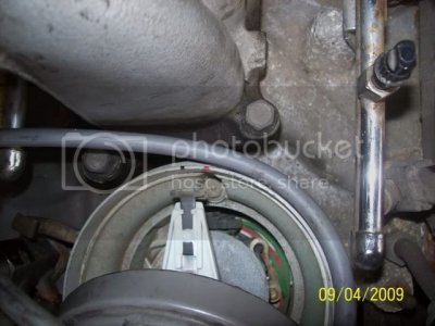

Grab the distributor and cap, and make a mark on the distributor plastic base for contact number one. This mark will be in the same spot as in this picture. Going by the ***** in the picture, number one will be just to the left of the ***** as seen by the black mark in the picture. Make a mark like so.
Step seven.
Time to drop the distributor in. Start the drop so the rotor is to the left of the black mark, ignition module at 45* angle. Now when the distributor gear marries the cam gear, the rotor will spin clockwise. You want to drop it in so the left tip of the rotor is about to make contact with the black mark like seen in the picture below when the distributor is fully seated. This will be real close to 10*BTC. And you'll be able to dial it in once running with a light. You also want to drop it in so that the ignition module (if equipped, if not, flat spot on distributor) is pointing at a 45 degree angle. Basically, aim it so it's pointing towards the driver's side head light. This will allow you maximum room to turn distributor both directions when setting final timing with a light. Then tighten the hold down bolt snug so the distributor turns but not to easily.
If you have the distributor fully seated into the block, and rotor positioned as shown in photo above (left tip rotor meets contact point of number 1) then it's time to wire it up. If distributor isn't fully seated, it's most likely because the oil pump shaft didn't slide into the distributor. If this happens, turn the crank with a 15/16 socket & ratchet and it'll drop in once the distributor turns. Won't take much of a turn. Then tighten the hold down bolt snug so the distributor turns but not too easily.
